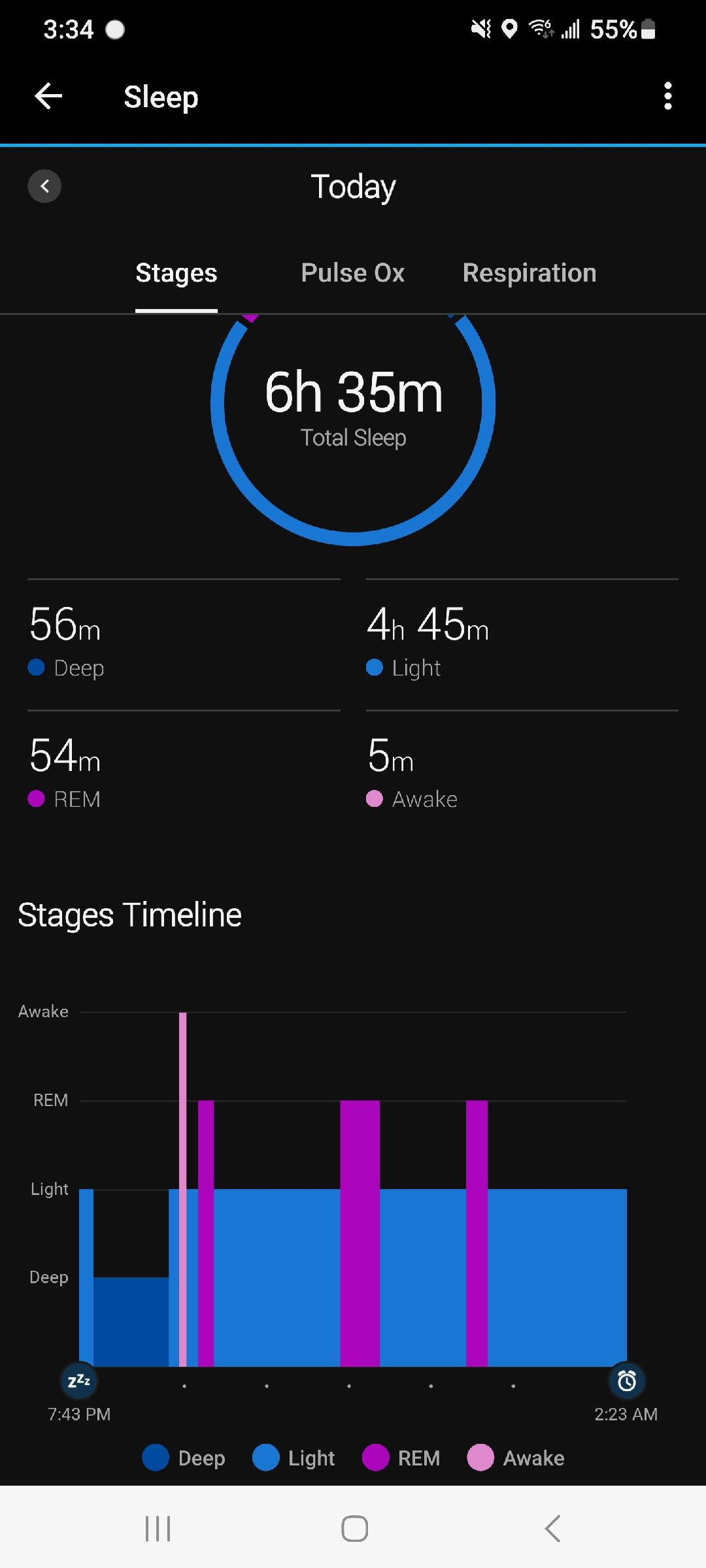

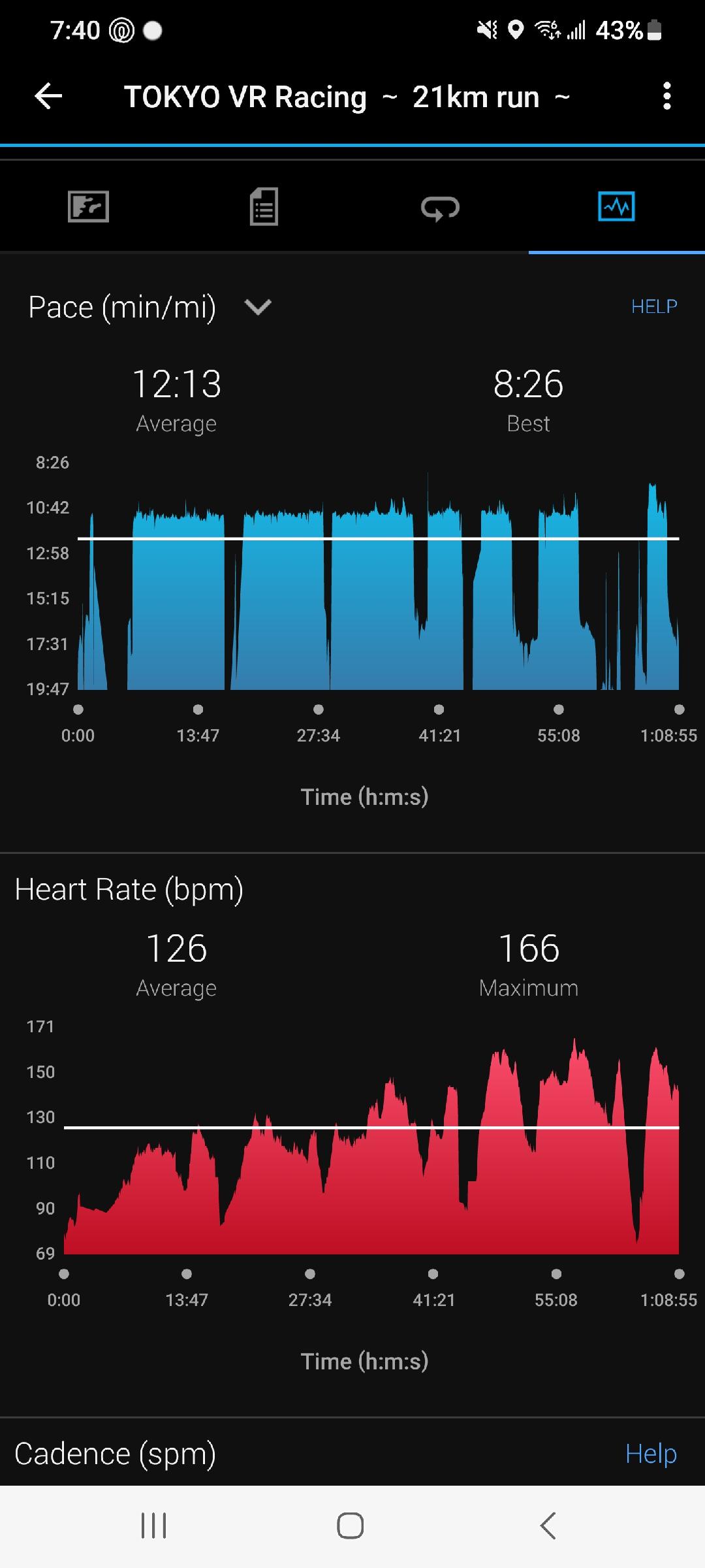

Slept very poorly last night, little REM and deep sleep. Got up just after 2a and felt very tired but could not sleep. My training peaks 140.6 plan had me doing a zone 2 easy run for 1h 10 minutes. I got myself on the treadmill and the first 30 minutes at an 11min/mile or so pace my heart rate was in zone 1. Then, it jumped to zones 5-6 and I literally had to stop running and lay on the treadmill to get it down. Once running slow again it jumped back up. I’m in great health and have no heart issues. Maybe just fatigue from poor sleep? Anyone else experience this ?

I think this may be the culprit…I use my 945 when running on the treadmill as its my speed/cadence/HR sensor for Rouvy. It works better than a footpod for virtual runs I’ve found (pace is more accurate). I’m wondering if the HR strap is the solution…I have been using the 945 for HR because starting a run with a “dry” HR strap slips down too much unless uncomfortably tight or if I pre-wet the HR strap band with water first (I use a Coospo HR strap indoors as its BLE vs my Garmin Tri HR strap which is ANT+ and won’t connect to my Apple TV box for Rouvy) I’ll try using the Coospo HR strap in conjunction with the 945 and see if my HR data normalizes. On the comment above about a Doc…yes certainly I will get a checkup if this irregularity thing continues but I think it may be technology (wrist vs strap). I appreciate everyone’s feedback, this is a great website!

Our squad uses HR for training and we have everyone wear chest straps because of nonsense optical HR tracings like the one you posted. If you’re going to use HR for training or read anything into it make sure you’re getting good data.
A simple test for anyone who thinks their Garmin is giving good optical HR data is to go for a run with the watch strap in your hand. Obviously you can’t get actually get an optical HR reading like this but you will end up HR data just the same.

Yes to both #1 and #2…I didn’t feel like I was in Z6 HR at all, no dizziness, no out of breath… and did feel my carotid for a few seconds and HR was thumping but no where near 166 bpm. You bring up a good point sir, I was running outdoors with a friend wearing my 945 for HR (no strap)…he’s a lot more fit than I and I remember telling him “wow my watch says 172 bpm”. I also remember being in “conversational breathing” and at 172 which I have hit running hard before I was gasping for air. Point being if a watch says your at very high HR and you body feels in Z2-Z3 (respiration, carotid pulse etc) its probably junk data. On the flip side if I ever felt dizzy, unnaturally short of breath or certainly felt chest/arm pains its a 911 call.

From your screenshots (that don’t show the sudden spikes) it looks like you held an easy pace whilst your HR drifted up throughout. Is this normal for you at that pace? If not, could be a sign of fitness or poor sleep.
when I’m in good shape, my HR will sit at the same level for for 2-3hrs while effort is the same. Seeing a constant rise within a 1hr workout looks wrong for someone who says they’re in great shape.

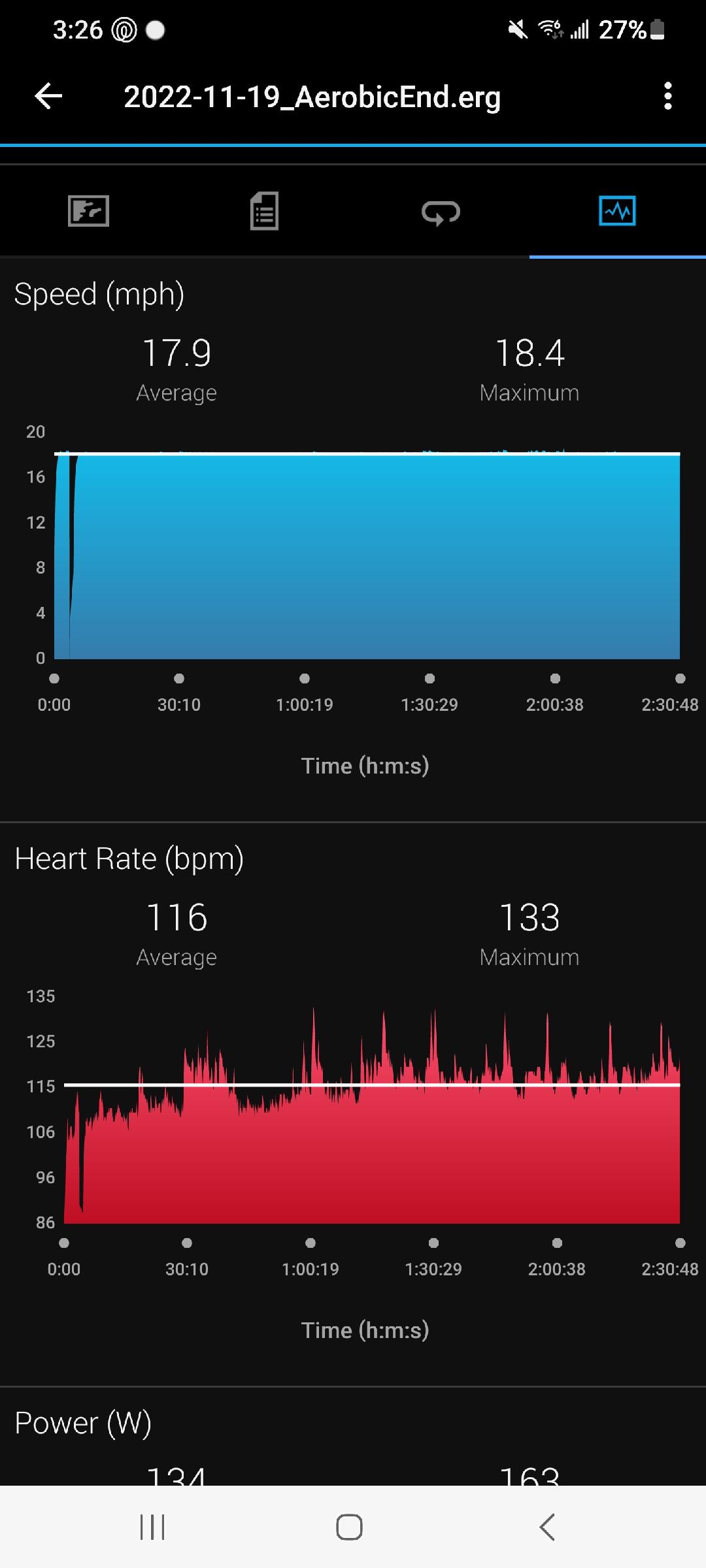

…“great shape” is relative right? I’m actually not in great shape, my last race was late Aug and I’m just now in base 1 for the Couer D’Alene Ironman next June 2023. I’m really starting to suspect my 945. Below is a screen shot of a recent spin. My watts were pretty constant but I do see some HR blips. These may also have been from coming up out of aero, taking a long drink and not breathing, that seems to do it sometimes. For the gentleman who asked above I’m 53, will be 54 next April. Ill wear my HR strap tomorrow (Garmin tri strap connected to my 945) on a 2.5h spin and report back. As awesome as my 945 is I still question the optical sensors. I’ve been laying in bed wide awake with insomnia and its said I was in light sleep! Thanks again everyone !

PS: The Sleep detection uses the accelerometers to determine how still you are as well as HR. So, a low resting HR, lower respiratory rate, and laying very still can easily be detected as light sleep.
