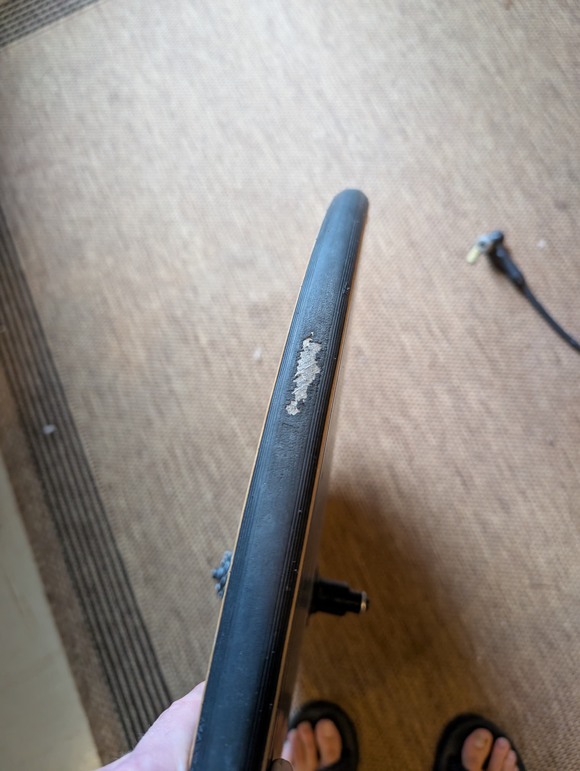

Anecdotally, my experience with the Corsa Pro Speed 26mm set up tubeless has been good. I’ve had zero flats so I can’t necessarily say it’s more fragile, but it is definitely less durable than other tires I’ve used. Went from no obvious damage to this after my 70.3 last weekend:
That was probably six 70.3s and one 140.6 plus the occasional prep ride. I used to be able to get much, much more out of the michelin power tts I rode before swapping to these and tubeless.

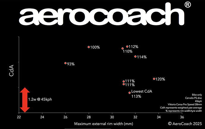

This is great. Thanks Xav. Hopefully you can include wider rims in the test to see how they perform, like Scope, Hed, PCW and the new Roval CLX Sprint which supposedly Remco used in Paris.
Yes we have wide rims in this test, it’s focused on deeper TT/tri wheels - the Reserve is the widest at 38mm, the Vision 91 is about 33.6mm etc.
We will be publishing data on that Roval wheel, but it’ll likely just form part of a road racing wheel data set.
Wider isn’t always better, and the 105% rule doesn’t work (as I’ve consistently said so!), there’s just no relationship between tyre width and rim width and the aero performance in this test. For example here is a subset of the data exploring that (excluding the Reserve as we used a different tyre, 29mm not 28mm so it’s not a fair comparison):
https://aero-coach.co.uk/cycling-wheel-aerodynamics-105-rule-is-it-true-with-modern-wheels
This is great… at a quick glance in this test, it looks like the best aero was probably >110, right?
I get “wider isn’t always better.” But is it fair to say that wheel width greater than the tire’s measured width is mostly better? (Only one combo looks like it had a tire narrower than the wheel, and its CdA was not special.)
Is every dot on this chart a different wheel ?
I think that wheel at 93% is a good example actually, it’s 5th on the ranking out of 9 in terms of CdA, so there are 4 wheels worse than it which have tyres wider or equal to the rim and 4 tyres better! Of course a 30mm tyre on a 20mm wide wheel will be terrible but when you start getting closer it’s not so clear cut.
The fact that the best/fastest wheel is 113% and there are two wheels slower at 112% and 114% really highlights how it’s just not a metric to determine speed.
Yes that’s right
so basically at this stage the 105 %rule is a " scam" lol
I’m not sure this proves anything. I think you would need to test varying tire widths (<100%, 100-110%, >110%) with each wheel to really prove out the 105% rule doesn’t apply.
This is what I am trying to wrap my head around
The highest CDA wheel is 112%, the lowest CDA wheel is 113%. Both have the same external rim width.
All this shows is one wheel is faster than the other, and unrelated to 105%
What am I missing ?
