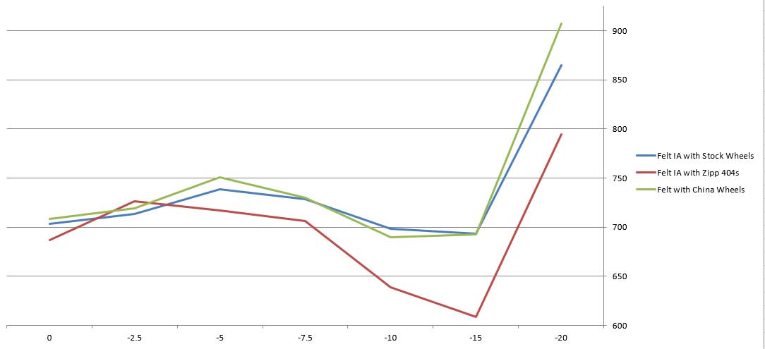

And in my limited experience, we tested a Chinese Zipp knockoff (40 to 50-ish mm depth) in the wind tunnel and found it performed worse than even stock options such as the Mavic Aksium.
I’m going to call bullshit on that.Call it whatever you like. We paid our way to the Texas A&M wind tunnel a few years ago and did our own testing. We learned a lot. It was expensive. John Cobb went with us to show us the ropes. Here’s a look at our trip if you’d like to at least validate we went:
http://www.trishop.com/plano/aerodynamics
Our testing wasn’t scientific (although our wheel testing was the best controlled testing we did) so the data isn’t suitable for publication. But we did try to do some analysis and here’s what we found with Zipp 404 vs Stock Wheels vs the chinese wheels we used on a Felt IA (integrated cockpit) with no rider:
This data should be taken with a grain of salt, and we had ZERO expectations about how the chinese wheels would perform. We didn’t control for tires. We didn’t get multiple data sets to validate a run. The entire purpose of our trip was educational.
We expected to get performance somewhere nearer the Zipps than the stock wheels, but our findings were the opposite. The knockoffs performed virtually identical to the stock wheels.
