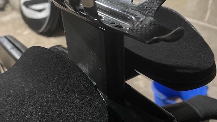

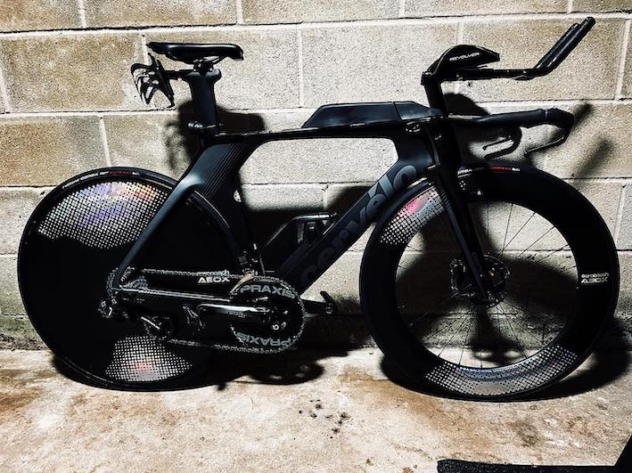

I’ve been building mine up over the winter. Have put Revolver long arm rests which narrowed the space where the BTA bottle cage should go, so I am experimenting with a 3D printed platform. Has held up so far…
Amazing bike, but isn’t that the p5? I think he’s looking for what used to be the p2 version, and is. Ow called the p-series.

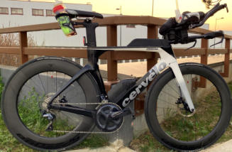

That is my training / long distance setup. Stock with raisers, I still have the chimney. My flat and toolkit is in front of the step, my food back hanging behind the bottle. A mini pump is attached to the side of the BTA bottle as well, the GPS attached to the right extension bar.
Not super super aero but all in one place and I am completely autonomous day-long rides.

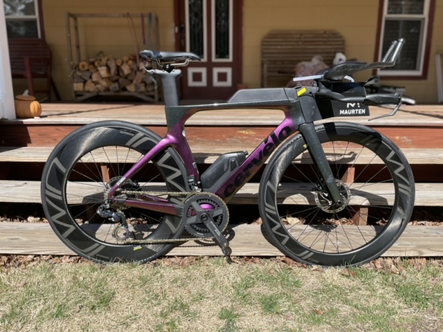

Here’s my most recent picture. I go back and forth between using the Torpedo BTA or just a standard bottle. The Scoops were the most recent, and probably my most favorite addition. Instead of mounting the junction box on top of the stem, I decided to route it into the bento box by cutting holes in the front of the bento box and the other plastic piece. It takes up a bit of room, but I can still manage to fit 4-5 gels.

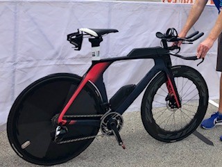

Forgot to follow up, but finished my friend’s P-series.
Bike is built with Ultegra R8050 Di2 components, the Di2 compatible TRP brakes, Irwin whees, a Profile Design Aeria Ultimate V2 stem, Vision Trimax Si013 base bar (the Metron bar just without an integrated stem), and Vision Metron TFE extensions.
Picture attached
Cool!
are those 28mm GB5000s? no problems for clearance?
