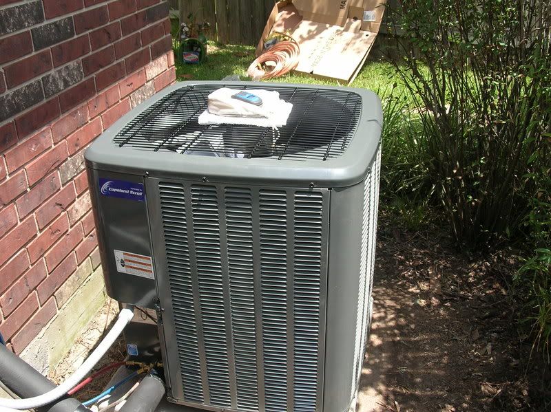

http://i87.photobucket.com/albums/k144/xcP_2006/DSCN2496.jpg
http://i87.photobucket.com/albums/k144/xcP_2006/DSCN2495.jpg
http://i87.photobucket.com/albums/k144/xcP_2006/DSCN2497.jpg
http://i87.photobucket.com/albums/k144/xcP_2006/WorkTruck002.jpg
http://i87.photobucket.com/albums/k144/xcP_2006/WorkTruck003.jpg
