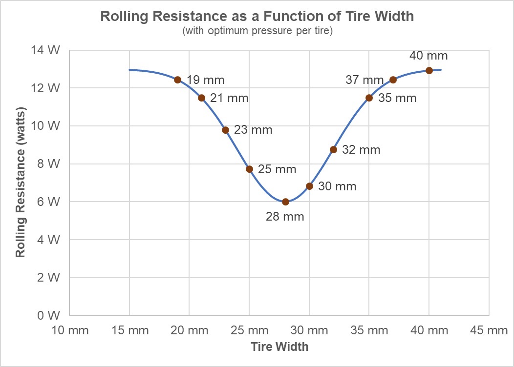

Certainly there is going to be a point where rolling resistance increases with additional width. The biggest toroidal tire that you can fit is ~350mm wide. It would literally be the shape of a donut with a tiny little hub through the middle. I don’t see any reason to suggest that such a large amount of flexible casing would produce lower resistance on anything but the harshest of surfaces. Remember on a theoretical perfectly smooth surface the fastest theoretical tire is completely rigid. Of course this provides no grip and isn’t a real world case, but it’s a good spot to ground your thinking. Everything past that is a balance of absorbing surface imperfections with minimal flexing losses in the casing.
It needs to be tested, but anyone who’s ridden a MTB or fat-tire bike on a road can feel the difference in rolling resistance between those tires and any normal road tire. I’m sure the knobs have an impact on that.
PS - Did you make that graph? I’d be curious to see the article it came from if you found it online.
PS - Did you make that graph? I’d be curious to see the article it came from if you found it online.I made it in Excel to illustrate my question. The data are nonsense - just illustrative to fall in the shape of an inverse bell curve.
don’t you think it’s generally accepted that wider tires offer less rolling resistance than narrower tires - up to a certain width, with that width being probably 30mm to 32mm - and the limiting factor is aero?
It seems to be generally accepted but I don’t know why. I personally don’t subscribe to it as I don’t think we have definitive data on it. We have sites like BRR that show a 28mm rolling faster than a 25mm at the same pressure but that doesn’t translate to the real world. I think this confuses many and it leads to a false narrative. Lets assume 80 psi is the break point pressure for the 25mm tire, you wouldn’t run the 28mm at 80psi. You would run it at say 75psi. What is the crr at the breakpoint pressure of the 28mm tire vs the 25mm tire at 80psi? This has been discussed several times on here and I forget who it was but someone mentioned that the crr would be roughly the same.
if you lowered the pressure, going from 25c to 28c, by only 5psi then the 28c would well outperform 25c on a drum roller. it’s more like 10 psi or more.
