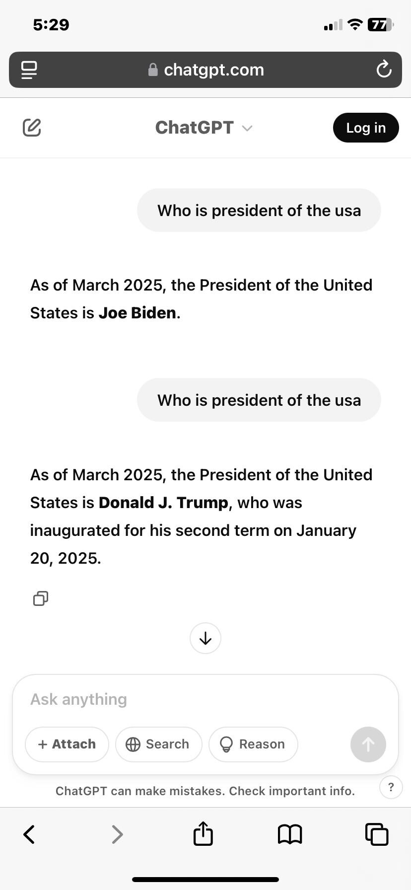

LLMs use the training data they have been given to create the most statistically probable responses (literally trying to predict the next word they should write). They are great for summation and aggregation (ask one for a five paragraph essay on the Treaty of Versailles and it will do a bangup job since there are lots of example to train on), but not as sources of truth. It’s that “looking for the most probable word” that leads to hallucinations (combined with some purposeful randomness). They just are not that good at differentiating opinion from fact, or knowing that they don’t know something.
Here’s an example I often use (below). I asked ChatGPT the same question twice in March of 2025.

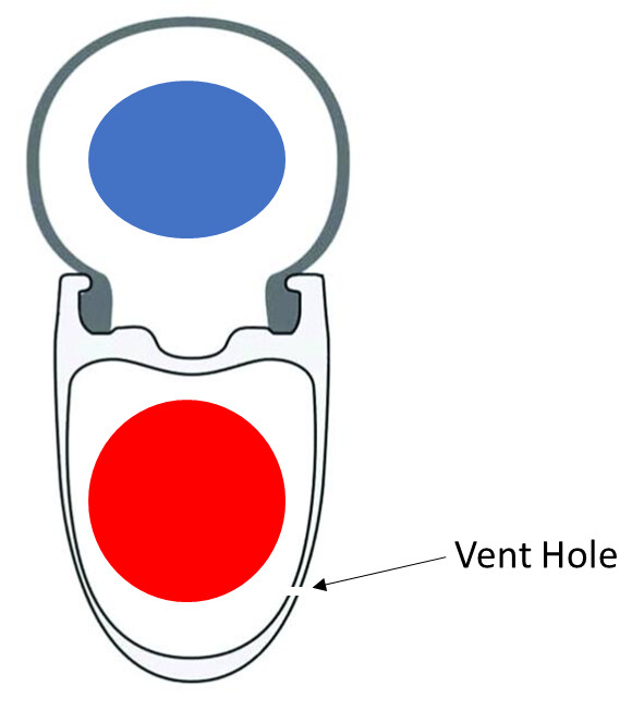

The vent hole is to prevent structural damage if air leaks from the tire/rim bed area (blue) into the rim body (red). A cover would have an additional hole, or enough access to atmosphere (ex. the valve cutout) that one is not needed.

The valve hole on many of these is fully enclosed, and doesn’t vent the inside of either the rim or the skin. A surprisingly large number of them don’t have vent holes in rim or skin, and I have seen wheels with vented skins that had un-vented rims (and were destroyed by leaking rim strips as a result).

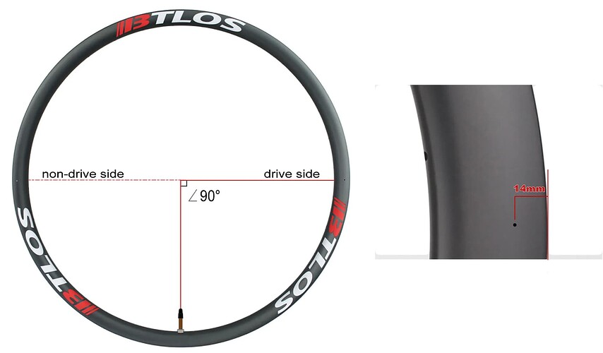

I know, right? Except when I tried to drill this 14mm hole, the tire wouldn’t stay on the rim anymore.
14mm is a big hole! ![]()
Those look like super legit wheels too.
The hole should not be 14mm in diameter, that hole should be spaced 14mm from the edge of the rim.
A 14mm hole would affect the structural integrity of the rim, the hole itself would only need to be 1mm in diameter to allow air to escape.
Ahh, ok I was confused. Do you think they mean metric mm’s or imperial mm’s - I’d want to make sure I use the right side of the ruler.
