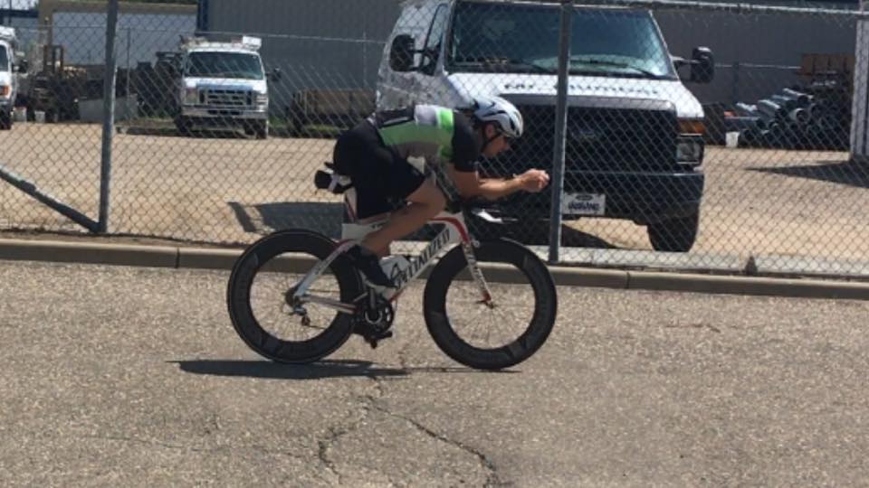

I am on a Large Spec. transition. I have a -45 adjustable stem (long story).
I have never been more comfortable on this bike than these last 2 months since lower the front end with this stem. Power is also up.
My local dealer carries Specialized and Trek. But not sure I can fit either bike.

179cm height
740mm saddle.
Pad stack: 590mm
Pad reach: 505mm
623/486
you know you could almost switch bikes with BMS just above.
i would always trust drivers achieved on the bike over my math. just, when padx and pady creep closer to each other, such as fewer than 100mm apart from each other for a rider aboard a size L or 56cm or 58cm bike, that’s a sign of a very aggressive position, even if you’re long torsoed. while this position may in fact be correct for you, i wouldn’t expect my math to generate such a position.
Here is my current position:
https://www.facebook.com/...p;type=3&theater
i wouldn’t counsel any change. that said, on paper, saddle height of 740mm, typical pro or top AG triathlete, the expected armrest elevation drop is about 12.5cm to 13cm, something like that. my guess is you’re 16cm, 17cm, maybe more. i don’t know.
the reason we don’t want those big drops is because you lose mechanical advantage at TDC. however, you can ameliorate that by moving the saddle forward (opening that hip angle back up) and also by going to shorter cranks (making the top of TDC not quite so close to your torso).
because we are afraid of power diminishing with a really low pads position, if your power actually increased then we don’t have to worry about that. that’s why the math i’m using for this exercise is not for outliers. it’s intended to drive you toward the norm because this math is the result of a wager, that if you’re buying a bike you haven’t seen, and you have no idea what size you should buy and how it should be configured, we’ll wager toward the fat of the bell curve of good riders who ride good positions. you’re not on the high point of the bell curve. not everyone should be there. you obviously are a case where you need to deviate from the fat of the bell curve.
Very cool information.
I believe my old position was closer to the fat part of the bell curve. I have been working on getting lower for a few years now.
I use 165cm cranks. Just by luck my road bike and Tri bike have the exact seat height as measured from the flat part of the pedals to the seat. I ride the exact same seat and pedals/shoes with both bikes.
I have added pictures of last years position and this years position
This new position
