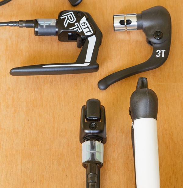

I just got some to use with TriRig Omega brakes. The Omega works best with levers that pull a lot of cable, and I measured the 3T Pro as pulling more cable than any other lever I’ve measured, so I thought the Team version probably also pulls plenty of cable. It uses MTB cables, and I don’t have any of those lying around, so haven’t been able to measure the cable pull yet. The other option was Magura, which I already had as they came with a P5-3 frameset I bought. This is how the two look next to each other:
http://www.cloudedforest.com/sharedfiles/3tteamleversvsmaguras.jpg
The 3T shape blends in nicely with the bar if you aren’t going to use bar tape. Also, the lever part has an aerofoil cross-section all the way apart from the small sphere on the end. My feeling is it’s unlikely to be less aero than the Magura lever, and I’d rather have the convenience of mechanical brakes for ease of installation.
