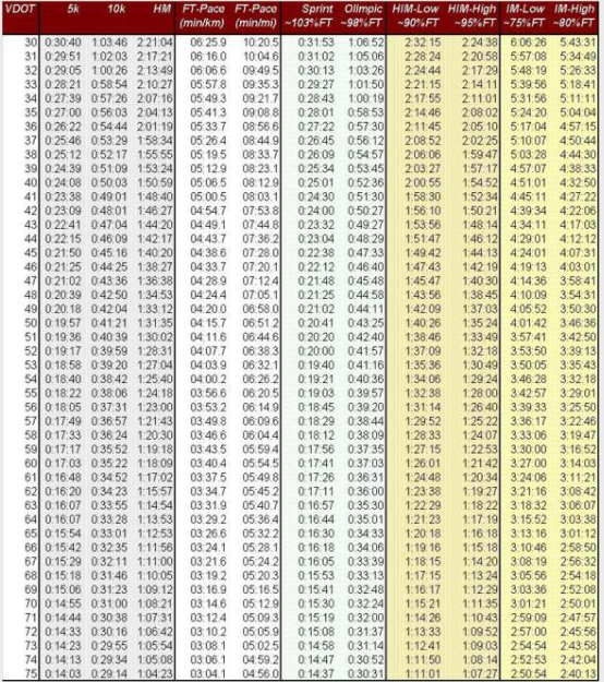

This chart has been reasonably accurate for me.
https://images.squarespace-cdn.com/content/5542d992e4b090e0afa6fca1/1435289880664-L4S55NARFULAVFUCBOMC/?content-type=image%2Fpng
Stand alone Marathon pace should be roughly the same as 70.3 run pace.
That chart is great. I’ve been using it the last few months for training/racing. I think 70.3 run pace should align pretty closely with open marathon pace. What prevents people from getting there in a race? Bad pacing on the bike, not training for a half marathon on tired legs, poor nutrition, and bad pacing early in the run (throw in not adjusting for heat/terrain into this). So many people fly out of transition, run their first mile or two 30 seconds faster/mile than what they’re gonna do the whole thing in, and then post a Strava caption saying their strong bike leg did them in. Sometimes that’s true but that runner could probably hold something in between what they went out in & their overall pace. That pace usually corresponds with open marathon pace or open marathon effort (a lot of run legs are in trash running conditions). The 13.1 miles at the end of a 70.3 should be treated like a marathon both pace-wise and in approach. Go out slower the first third of the race than your goal, settle into a rhythm in the middle of the race at your goal pace, finish strong/pick it up if you have the legs for it. Fuel. Fuel. Fuel.
The ranges in that chart are helpful. Take your open times to find your range. Start off the run leg of your next 70.3 at the slower end of the range and pick it up if you’re feeling good.

Another rule of thumb that has been useful for me is that your triathlon run pace is the open run race pace of the distance longer. 5k, 10k, half marathon, full marathon.
So your sprint distance (5k) pace is your open 10k pace. Your 70.3 run pace is your open marathon pace. Etc
Just compared that chart to previous race run times, I fall in all the ranges. legit
