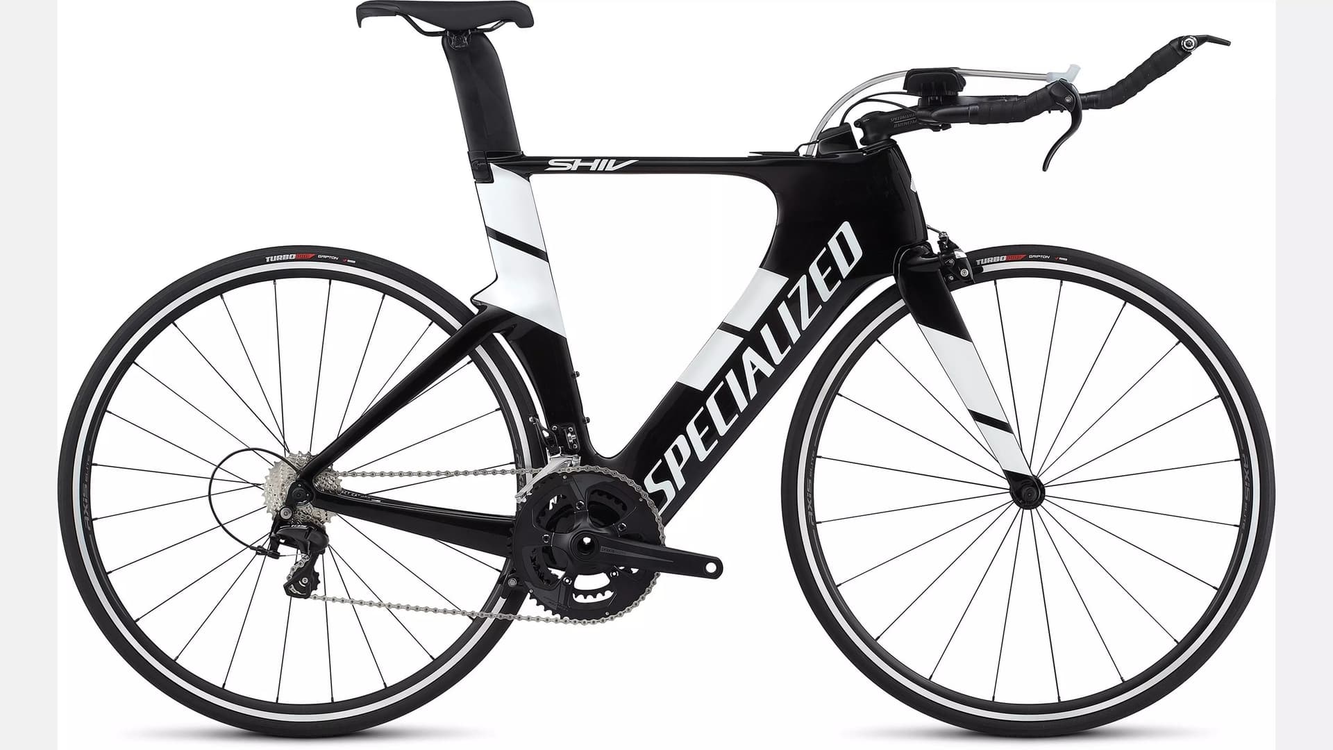

For others’ reference, here’s the current bike at factory spec:

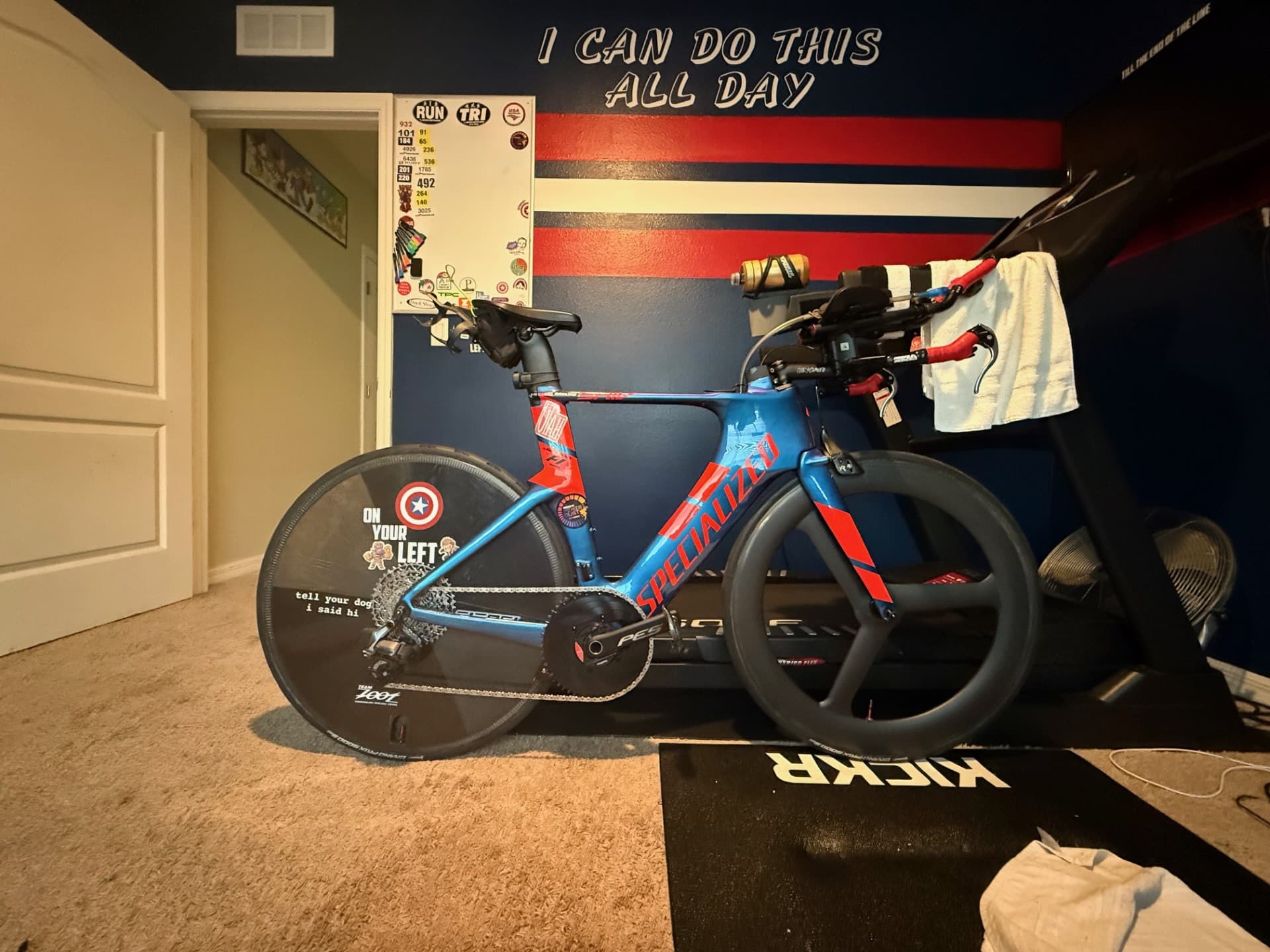

Currently have a 2019 Shiv Expert that I bought as a frameset and built up.
Personally I’d make sure the fit is dialed in first, so crank length, cockpit, saddle would be the first thing I’d look at for upgrades.
When I built this bike up I was able to bring over the Profile Design cockpit and I had the Tri Rig Omega brakes already and if I hadn’t I would have upgraded the standard Shiv brakes because I’ve heard nothing good about them.
Next up as others have said tires and waxed chains are going to give you a big return on a limited investment. Then I’d go wheels.
I JUST made the switchover to electronic shifting with SRAM and to be honest, it’s nice, but not as big a performance upgrade over doing tires/wheels/helmet and its WAY behind getting a good position. Another nice little touch is the outrider pressure sensors, its like having TPS for your bike and for very little spend its been ENORMOUSLY helpful in dialing in the right pressure because you can see it live.
As I said I just finished the upgrade to E-tap and am running big front with big rear cassette(11-44) I’m limited because my rear hub can’t be upgraded to XDR to take a 10 tooth cog. I was running mechanical 2x with a 53/39 and a 11-25 or 11-28 and most of the time I was in the 14/15/16 gear. So with the 11-44 and a 56 front I can stay most of the time in the 15/17/19 gears which are a similar ratio but more efficient. I might play around with going to a 11-36 Shimano over the winter just to see if I can get it to work with SRAM but I’m not that worked up about it. I’m also toying with the idea of losing some weight on the front end and upgrading to a Tri Rig Alpha One cockpit but that’s a ways down the line.
The Shiv’s a REALLY quick bike that’s fairly easy to work on and travel with, and I think it still holds it’s own against some of the newer disc brake models.
2019 Specialized Shiv
Size Medium
AliExpress 130mm Stem with Profile Design Cockpit 60mm Risers and 45/25 Aluminum Extensions and Profile Design Base Bar
Front: Ali Express Tri Spoke with Conti GP5000 TRs 25mm
Rear: Lightbicycle Falcon Disc Wheel with Conti GP5000 TRs 25mm
Fizik Trasiro Aeris Long Distance
Magene P505 powermeter crankset 165mm Shimano Ultegra pedals
Alugear 56 Tooth Narrow wide Front w/ Sram Rival AXS XPLR with SRAM Rival 11/44 Cassette
Sram Force Chain waxed with Silca Super Secret
