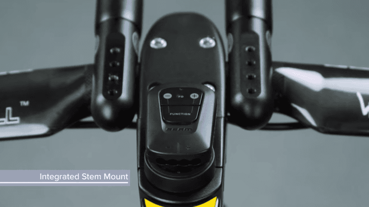

I have no installed the bridge. Assumingly it has to be in hte highest position (i.e. between the last spayer and the "pad adjustment spacer").
I have an etap and there is no great way of installing the blip box. I am thinking of using the bridge to install the blip box. This would also work with regard to the cable routing.

The top of the bottle is 45mm above the centre of the bar. Hopefully that helps you work out if there will be enough clearance with blip box.
Yes, bridge should be in the highest possible location.
The satellite magnet for the HSF aeria can be installed in that square hole in the centre of the bridge - so the hose sits above the bridge rather than trying to thread it underneath each time.

Doesn't the blip box use a Garmin 1/4 turn-style mount? If so, why not get a stem cap mount for the blip box, and run the wires through the Aeria stem? This would mean that the wires are almost invisible to the wind, the box is accessible, out of the way and as per Cyclenutz' diagram, it would likely sit out of the wind behind the hydration... (assuming it would fit there)
