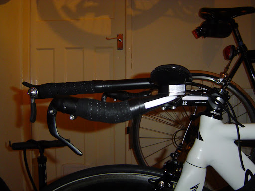

thanks for the input I am looking to use the extensions on a set of 3T mistral bars so the cable would be exiting at the rear and i would only need to cut out 1 slot per extension similar to the slot on oval extensions that i am using at the moment!
I will look into borrowing a dremmel!
Would you use any glue or resin to seal round the edges of the slot?
Im thinking of using the lazy s extensions back to front as this will give me an extension similar to the blackwell wrist reliefs think I will have to trim a bit of the internal clamps on my shifters as well to make them fit!

Any chance we could get some additional Mistral pictures? Do you have the basebar slightly tilted down?
Does the bar come with all the hardware that is needed to run the extensions on top of the basebar?
Did you happen to weigh the bar?
Thanks for any additional info you can give on the bar.

I do have them slightly tilted down!
The extensions mount either top or bottom and I have used an oval concepts riser kit under the arm rests to get the right height for me relative to the extensions!
I didnt weigh the bar as I dont consider weight that important in a time trial!
